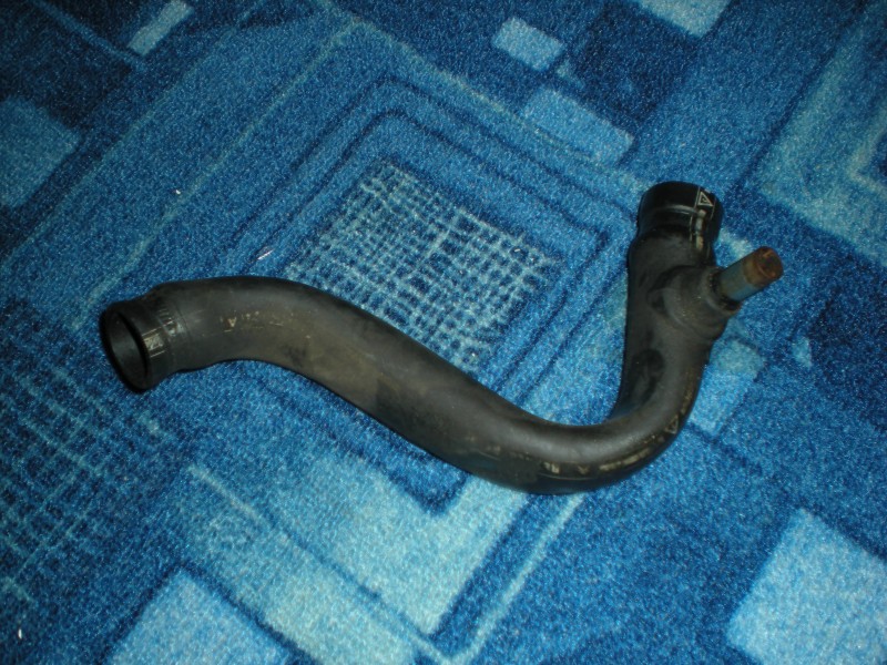

dalsi nesehnatelny zbozi do sbirky.Diky clenovy moze.czech! Neposkozena origo nalevaci hadice ![:urg: :urg:](./images/smilies/urge.gif)
